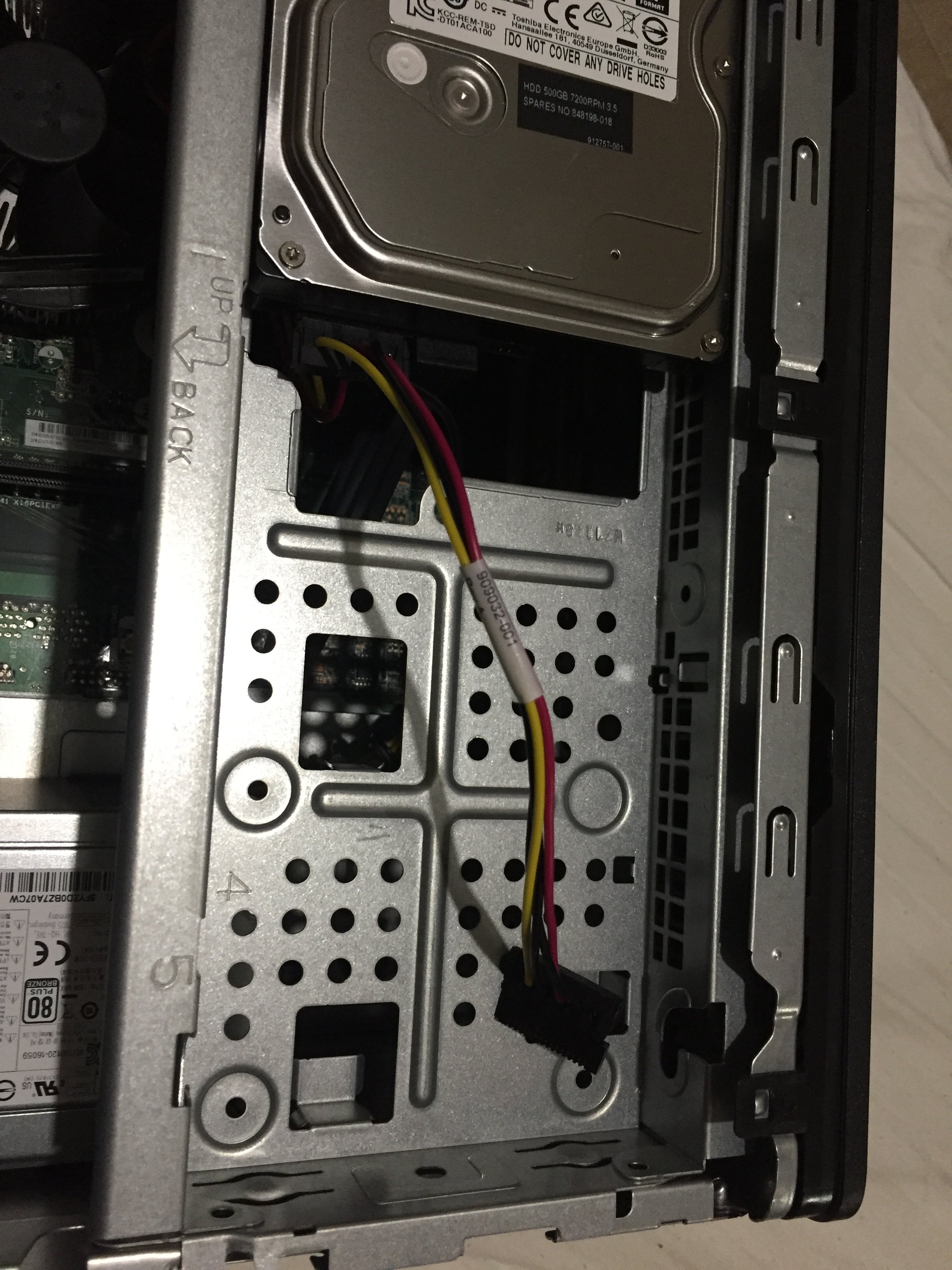

Hello! The “Crucial” is not available in Palestine and SSDs are very expensive here. You can say I have no knowledge when it comes to hardware. I have attached the pictures of the inside of the PC and I am looking forward to your advice on how to plug in the SSD. Thank you in advance!
I understand ;)
So you need to have, an SSD, a SATA cable and available port on your mobo. I think that pictures will explain better than my words
SATA cable goes from Motherboard slot into an SSD, and Power cable (wider connector) goes from your power supply to your SSD.

Thanks for the guide. Currently I don’t have a SATA cable, so I will use the one connected to my HDD. Just to test the HDD and install Windows. Thanks again
