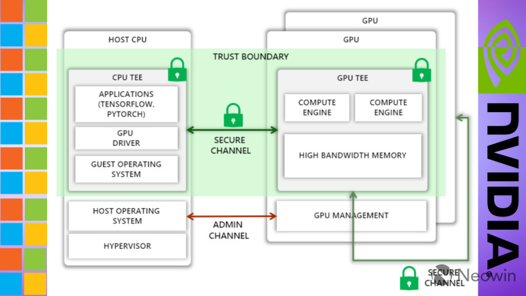

However, existing solutions are tied to TEEs being built in CPUs, so Microsoft is now looking to extend this boundary to GPUs as well, making sure that data can be securely offloaded to more powerful hardware for computation needs. This is even more important when it comes to AI workloads for organizations, and Microsoft is collaborating with Nvidia on this front.
A graphic for Microsoft&039s vision for confidential computing with NVIDIA GPUs
Microsoft has noted that this is not a simple implementation as it needs to protect GPUs from various attacks while ensuring that Azure host machines have adequate control for administrative activities. Even at a hardware level, the implementation should not have negative impact on thermals and performance, and ideally, should not require changes to the existing GPU microarchitecture either. The company's vision includes the following capabilities for confidential GPUs:
  • A new mode where all sensitive state on the GPU, including GPU memory, is isolated from the host
  • A hardware root-of-trust on the GPU chip that can generate verifiable attestations capturing all security sensitive state of the GPU, including all firmware and microcode
  • Extensions to the GPU driver to verify GPU attestations, set up a secure communication channel with the GPU, and transparently encrypt all communications between the CPU and GPU
  • Hardware support to transparently encrypt all GPU-GPU communications over NVLink
  • Support in the guest operating system and hypervisor to securely attach GPUs to a CPU TEE, even if the contents of the CPU TEE are encrypted
Microsoft has stated that it has already built confidential computing capabilities in Nvidia A100 Tensor Core GPUs on Azure. This has been done through a new feature called Ampere Protected Memory (APM). The implementation details are highly technical in nature and you can check them out here.
This solution is now available in private preview through Azure Confidential GPU VMs. Organizations can use VMs with up to four Nvidia A100 Tensor Core GPUs for their Azure workloads at this point. Microsoft's next steps include ensuring the broader adoption of these practices and working with Nvidia on its Hopper architecture for further enhancements to the existing implementation.
