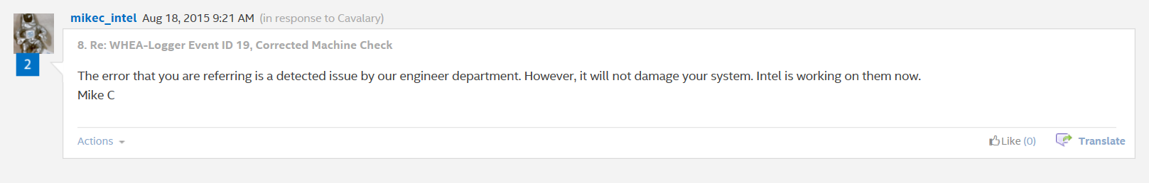

Somebody said from Intel:" Yes, that is a good idea. You can check the motherboard's forums. As mentioned before, I would contact ASUS support first they might help you identify if there is something wrong with the motherboard. Since one of the triggers is plugging with the video card, yes it could be related to card or drivers. "
So maybe its related to this?
