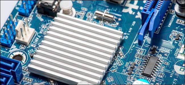

Definition of a chipset
An electronic chipset manages the flow of data between components on a motherboard. It’s the traffic controller between the CPU, GPU, RAM, storage, and peripherals. Experts have referred to it as the “glue” of the motherboard. The chipset is basically the electronics on the motherboard that communicate with all the connected components.
In a nutshell, a chipset acts like the motherboard’s communications center and traffic controller, and it ultimately determines what components are compatible with the motherboard—including the CPU, RAM, hard drives, and graphics cards. It also dictates your future expansion options, and to what extent, if any, your system can be overclocked.
You've probably heard the term "chipset" tossed around when talking about new computers, but what exactly is a chipset, and how does it affect your computer's performance?In a nutshell, a chipset acts like the motherboard's communications center and traffic controller, and it ultimately...
