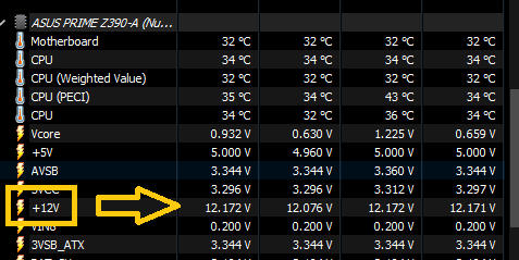

What I suggest is to get a rough idea of what the 12 volt rail is getting in terms of power. If you can get a volt meter from somewhere, that would be ideal. Do you use HWiNFO? If you do, next time you're in-game, set your overlay to include the GPU rail voltages/ PCIe +12 volt Input voltage. Or, you can look at the standing voltages under your motherboard's heading in HWiNFO but I don't think that's going to give the full picture. For example:
You (or someone) can also try another psu to verify--if this is a doable thing. Edit: You can search this issue online also and see what turns up. For example: one source suggested to turn g-sync/v-sync off in the NV control panel If you have that, try setting all to defaults.

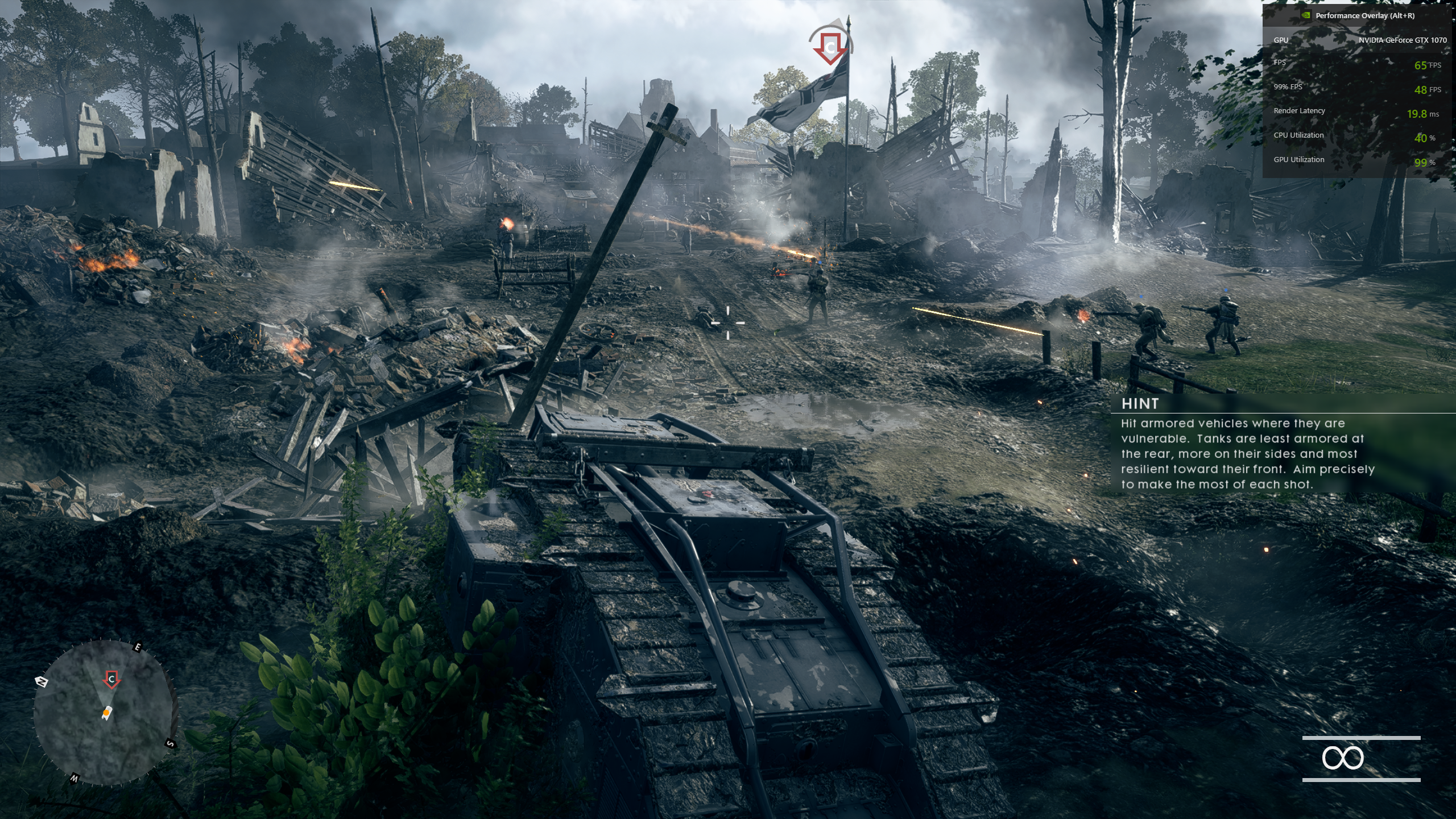

in many games including old ones game like Black ops 3 I was getting about 180 FPS on 1080P now I am getting 70 by maximum and it doesn't matter if I play on 1080P or 1440P the GPU utilization stays at 60% and get same FPS
