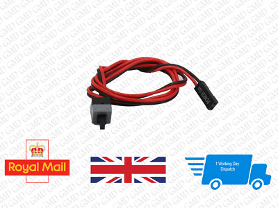

or a cheap power switch to test:

Those replacement switches are nice for troubleshooting but there is no assurance they will fit the case as far as mounting is concerned - so they are not a permanent solution.
If your case has a reset button, you can simply move the two wires for the reset button to the two pins on the motherboard used by the power button, then just use the Reset button as the power button from now on.
