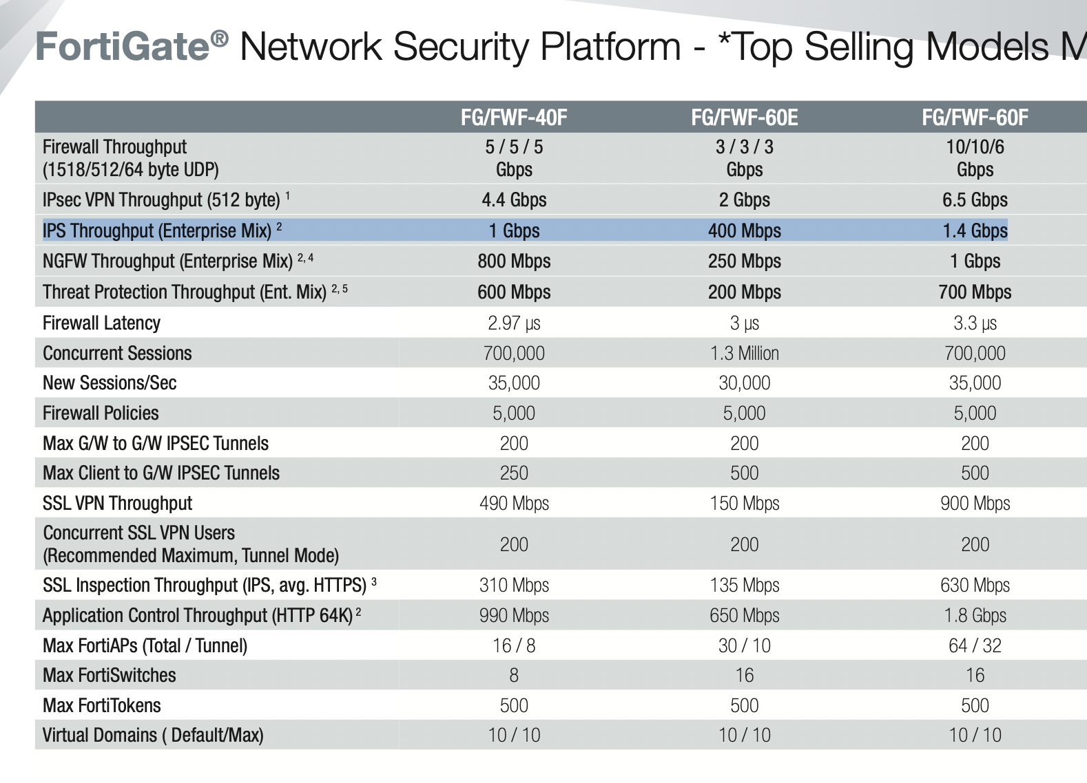

All these hardware devices will affect your throughput especially if you have Gbps line. If you are still having Mbps line then it's ok. And if you want high throughput then you need to pay for the more expensive models.
Edit - Changed Kbps to Mbps
All these hardware devices will affect your throughput especially if you have Gbps line. If you are still having Kbps line then it's ok. And if you want high throughput then you need to pay for the more expensive models.
Fortinet is a pretty notable exception to that. The 40F is $360 and does 1gbit IPS and 4+gbit IPsec VPN with AES256-SHA256. The 60F costs about $600 and is even faster, which is my recommendation for gigabit.
They build their own chips and almost everything gets hardware offloaded after the first packet is processed on CPU.
Those throughputs reflected in the table are enabling a single protection feature each or ALL the protection features simultaneously?
As a user I would like to enable ALL the protection features simultaneously
Also, looking at the models you can see that they are more for enterprise use like having 2Gbps throughput and above. For home users having 1 Gbps is more than adequate unless you are running two(2)x1Gbps lines for gaming or operating a business at home
"IPS" is just IPS but NGFW is IPS + web filtering and "threat protection" is all of that plus AV scanning and SSL decrypting/reencrypting.
Note that because Fortinet uses special ASICs for offloading, all of those things use separate hardware. Like just because you are pushing 1gbps through IPS, you can still push 6gbps through IPSec because the AES engine is separate from the IPS engine.
The numbers are a little hard to believe but yeah I am comfortably using a FG-61F to do symmetric gigabit upload and download. I've only had one or two workloads where the device couldn't offload and limited my throughput at 800mbps.
