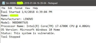

I thought I would idly check, as this machine (I thought) was clean and just being curious. The Intel discovery tool wiped the little smirk right off my face. So, I am much obliged for this post, @BoraMurdar. Next patch coming up.

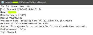

Edit: Just checking after applying the ME firmware update courtesy of above Lenovo link.
