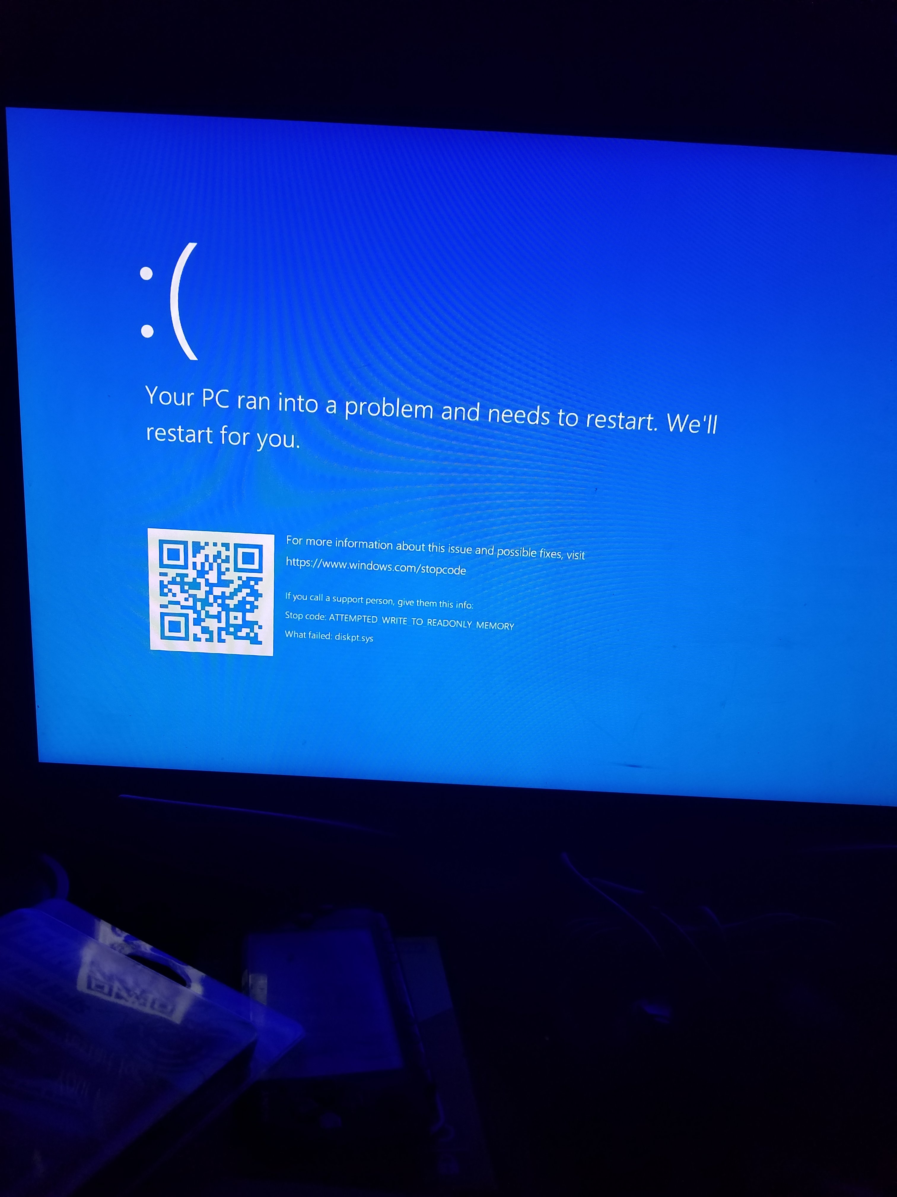

When I turn on Intel Virtualization through the BIOS, I get BSOD after the BIOS POST and begin to boot into the Windows.

You have to send the memory dump to Intel. Someone with the symbol files needs to analyse the memory dump to determine the cause. No one here can tell you with the infos you provided.
There is a utility out there that purportedly identifies the cause, but it is not foolproof; it can identify the wrong thing. The memory dump must be analyzed manually.
Get support from Intel and ask them how and to whom you need to submit this issue.

No crashes with Intel VT disable, but my PC can't boot into Windows with Intel VT enable.
If you have Shadow Defender installed... guess what ? You have to uninstall it if you want to use Intel VT.
You could also submit the memory dump to Tony = the developer of Shadow Defender. You have to get with sdmod over at Wilders to facilitate submitting the memory dump to Tony.

Update 2: Apparently, Memory Intergrity is the culprit causes my PC to crash when I turn on Intel VT in the BIOS. I have to go to the regedit to turn off Memory Intergrity.
HKEY_LOCAL_MACHINE\SYSTEM\CurrentControlSet\Control\DeviceGuard\Scenarios\HypervisorEnforcedCodeIntegrity
Enabled DWORD to 0 ( Turn On or Off Core Isolation Memory Integrity in Windows 10)
