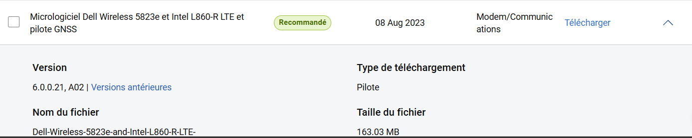

Here are the full Hardware IDs you requested
PCI\VEN_8086&DEV_7360&SUBSYS_00208086&REV_01
PCI\VEN_8086&DEV_7360&CC_0D4000

Those IDs help narrow it down: it’s clearly an Intel device (VEN_8086) and the class code CC_0D40 puts it in the wireless / special controller category – on a Latitude 5340 that’s very likely the Thunderbolt/USB4 controller (or a closely related Intel chipset function), not something like MEI/AMT.
I can’t say 100% which exact Intel chip it is, but on that model the missing driver is almost always a Thunderbolt / USB4 or Serial IO / chipset package.

That entry you found is this one (in French):
“Micrologiciel Dell Wireless 5823e et Intel L860‑R LTE et pilote GNSS”
Category: Modem/Communications – and it’s marked as Recommandé.
What it is
That package is the firmware + driver for Dell’s WWAN module (Dell Wireless 5823e, based on an Intel LTE modem – L860‑R, plus GNSS). In other words: it’s the mobile‑broadband/LTE card driver.
Given your earlier hardware IDs and the fact that this is:
  • From Dell’s site for the Latitude 13 5340 2‑in‑1
  • In the Modem/Communications category
  • Flagged as Recommended for your system
this is the most likely OEM‑correct driver for the unknown “Intel LTE” device you’re seeing in Device Manager.
Even though the BIOS didn’t show a clear “WWAN” toggle, it’s still common that:
  • The PCI function for the LTE modem is exposed to Windows
  • But the BIOS menu doesn’t show a separate WWAN option, or only shows it when certain configs are present
So BIOS not listing WWAN doesn’t necessarily mean the modem/PCI function isn’t there.
What I’d do in your place
Since you prefer to avoid driver utilities (which is reasonable) but are OK with OEM drivers:
  1. Download that “Dell Wireless 5823e and Intel L860‑R LTE and GNSS driver/firmware” package from the Dell page.
  2. Run the installer normally and let it complete.
  3. Reboot.
  4. Open Device Manager and check whether:
    • The yellow‑marked “Unknown device” (with the 8086:7360 ID) is gone, and
    • You now see something like “Dell Wireless 5823e / Intel L860‑R LTE” under Network adapters or Modems.
Because this is a Dell‑signed, model‑specific package, it’s safer than using generic tools or random driver packs.
If it doesn’t install or nothing changes
  • If the installer says something like “no compatible hardware found”, then your specific unit probably doesn’t have that WWAN module despite Dell listing the driver for the model series.
  • In that case, you can simply:
    • Right‑click the unknown device in Device Manager → Disable device.
  • If it does install but you don’t care about LTE at all (no SIM use, etc.), leaving the driver there is harmless; it just makes the warning disappear.
Bottom line
That Dell “Wireless 5823e / Intel L860‑R LTE” package is very likely the intended WWAN/LTE driver for the PCI device you’re seeing. It’s safe to try installing it; if it doesn’t detect hardware, just disable the unknown device in Device Manager and you’re done.
Upvote 0
