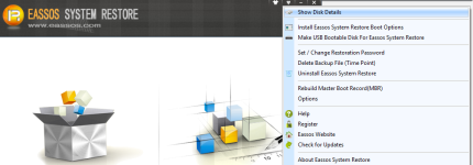

One issue I Dose not see my External hard drives , or it dose not like seagate.
1. Did you check whether your HDD shows up in the "Show Disk Details"?
2. Does your HDD have enough space to store a system backup?
I don't have an HDD, my USB is shown in "Show disk details" but not in backup location options, possibly due to storage non-availability.

worked it out , It did not show up in Show Disk Details ,
So format and split it , it was 4 TB now 2 TB X 2 TB
now it shows up in Show Disk Details and it works fine ,
Dont think it could read it as a 4 TB ,
