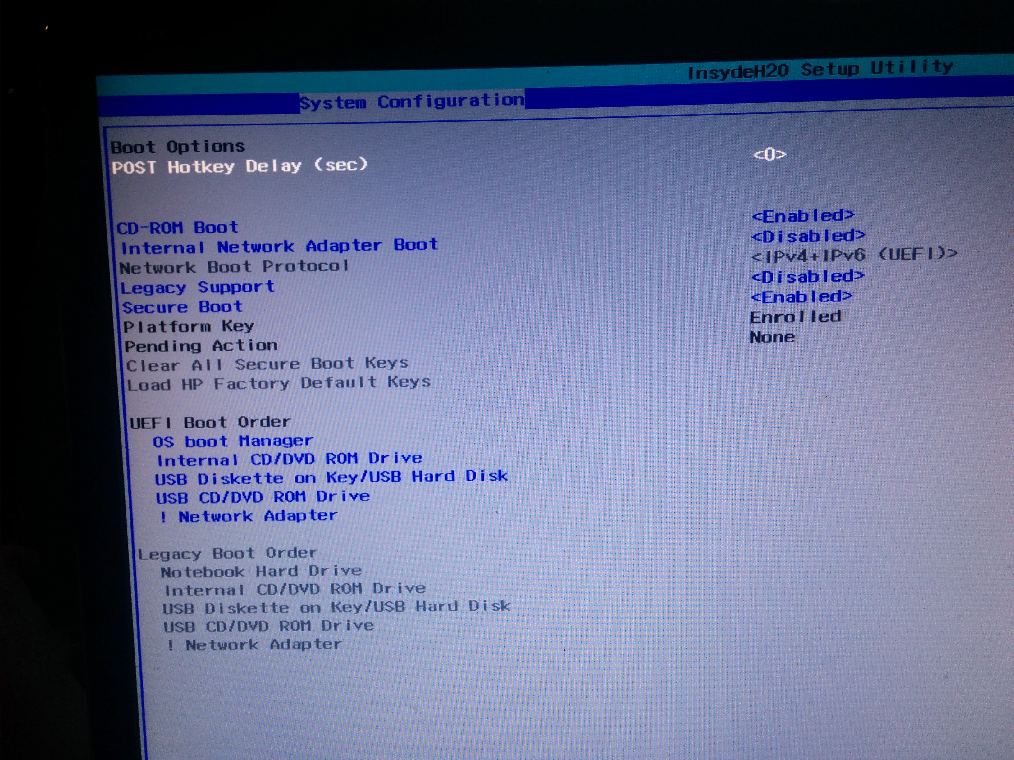

The Laptop is a HP envy dv7 it came with windows 8. The exact Error is Boot Device Not Found Please install an operating system on your hard drive. Hard Disk (3F0)
Sometimes the BIOS forgets where the hard disk is, this can happen after a bumpy shutdown, or after booting from another media. Everything is there, but BIOS is looking in the wrong place.
Go into the BIOS settings and make sure the hard disk with windows is at the top of the list. You might have to reset it in two different places, depending on the BIOS.

It looks right to me, but I would suggest enabling legacy mode and disabling safe boot, and see what happens.
It is possible that your hard drive simply failed, this is extremely common, and can happen with or without warning. Not all HDDs enjoy longevity. They can die at any age, it is totally unpredictable.
it starts up looks like my linux boot then says no operating system found

If you have the patience, you could test the hard drive by hooking it up to another computer and running scan disk on it.
Maybe others know more, that's about all I can think of right now.
If it looks like linux, maybe grub is starting up, instead of windows boot manager. You will have to get rid of grub, perhaps by booting from a CD with Gparted, or something like that.

Okay, but his problem is that he can't even reinstall Windows. When he boots from legacy, it looks like linux (which he had before).
Do you think that maybe it is booting from grub? If so, how can he get rid of grub?
