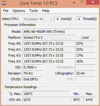

Purshu_Pro
Level 29
Aug 3, 2013
1,879
Well Its currently about 63 Degree Celsius.
Usually when I start my PC it will be around 49-55. And after that it stays in this temp.
Upvote 0
Enju
Level 9
Jul 16, 2014
443
The max. temp of this CPU is around 100ºC, the temperature sensor on AMDs current CPU lineup are also quite inaccurate, most likely the temp is 5-10 degrees lower! There is really no need to do anything about it as long as your notebook doesn't shut down because of the overheating protection.
