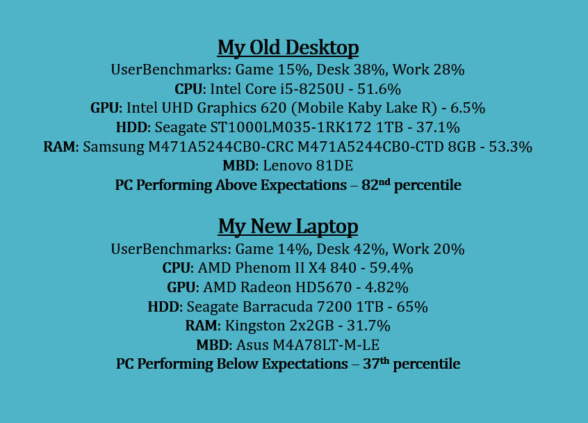

My desktop has a seagate barracuda 7200 and laptop has a seagate 5200 HDD.
Just did a userbenchmark test on both the systems.
Here are the results.
So this slowdown is due to hard disk only?

Well my best bet is that the problem is in fact the slow mechanic HDD, nowadays the bottleneck of most machines is the HDD, buy a compatible 256 gb SSD (doesnt need to be too high end) and you will notice how fast your machine will become.
Ofcourse it can be other problems, but usually just changing the HDD for a SSD gives the new generation laptops another tier of performance.
