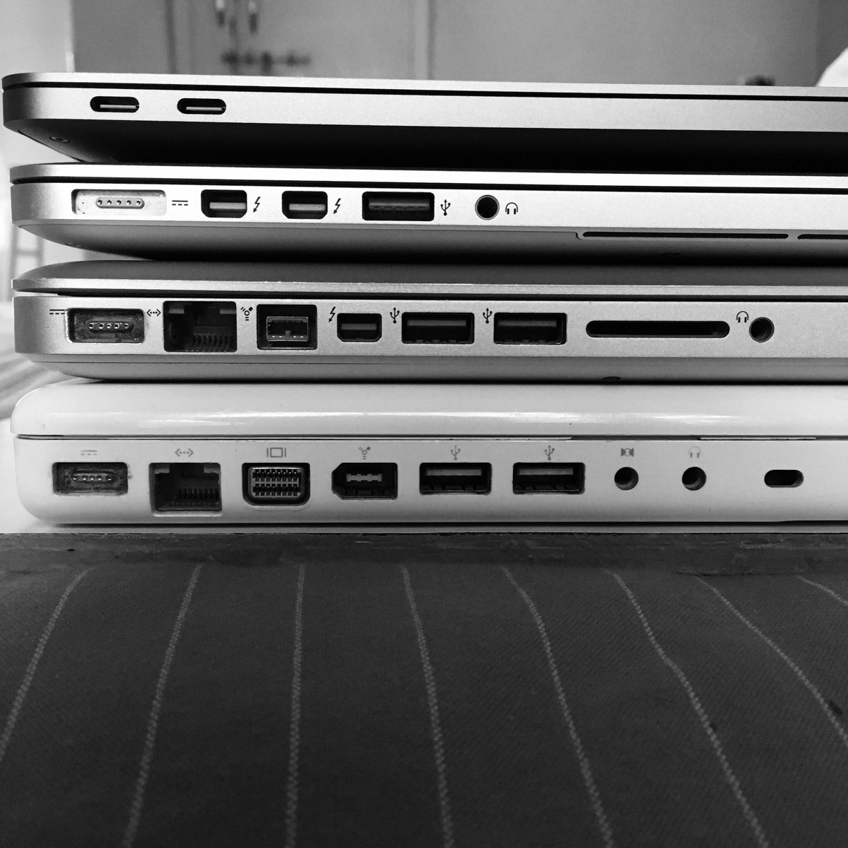

Ah the nice latitude of old days
Never forget what they took from us.
https://x.com/IntCyberDigest/status/2018828258658406698/photo/1
