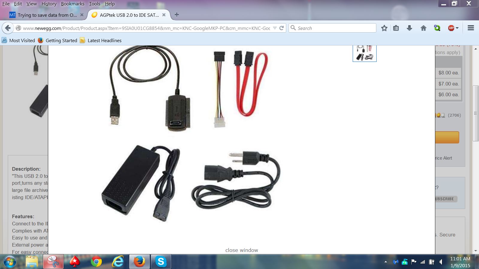

Hello :)
Is that an enclosure External HDD you use? That suppose to work well at any variants of Windows operating system in order to retrieve those files.
Make sure the cables are not malfunction in order to access the old HDD. Try on other computers if you can access it.
No is is just a system of cables and attachments to use to read an internal drive you have taken out of a computer ...usb

I have a usb adapter that doesn't handle all WD drives. Any other drive, and half the WD drives, it works famously, but for some WDs I have to use a diff adapter. So if you have another adapter you could try it.

You know those are great suggestions and I often try things like that too. But in this case I switched to my backup computer to use puppy linux and did get the dvd put in ..in time. so it booted to windows ...I thought what the heck let me try it with the usb adabter hookup and wow this computer read the hard drive. I got to the data and saved it all the person. So crazy all the ways we have to try things.
So everyone thanks for the great help and tips ...once again it was trying all the ways until one worked...i know someone had suggested trying a different computer. Anyway ...the problem was solved :)
