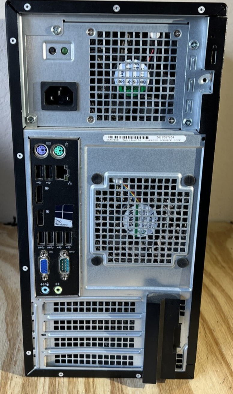

Another possible culprit is the Video Card if it has one. Is the back similar to this or if you can take a photo then we can have a better idea what components you might have.
No video card, I got PC with integrated graphics (to start out with) so I would be able to choose wisely, rather then paying so much for a video card to be on the PC already.
Gotcha! Then all you need to do is reseat every components that you can,isolate and see. If really no POST, then likely something needs replacement.
