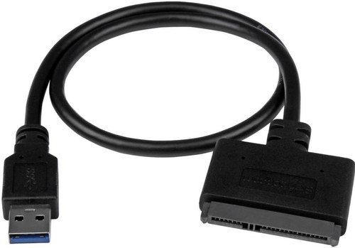

BACKUP EVERYTHING ON THE OLD DRIVE BEFORE CLONING just in case cloning doesn't go well. Format your new drive. If your laptop doesn't have second storage drive slot then you will need a usb to sata adapter. Cross your fingers during cloning. After cloning, disconnect the old drive then plug in the new drive. Go into the BIOS to make sure it does detect the new drive boot manager then exit out the bios then cross your fingers Windows does boot from the new clone drive.

If needed there are USB to SATA cables to copy content of the "old" HDD.
