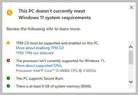

Sure, because of Win11 and also because my current PC, I got it back to 2016.
Look bro, the year doesn't matter.
Your CPU and Motherboard support Windows 11 according to the website official
The GPU doesn't matter, only Motherboard and CPU does matter of Windows 11..
Why I need to run the USB BIOS Flashback tool?
To support Windows 11. if you dont run it then doesn't support Windows 11 :) understand?
Yes, but King said this at the end of his message:
""- Support Windows 11 by default, no settings changes required in the UEFI BIOS."
Also no, my current PC is back to 2016 and doesn't support:
