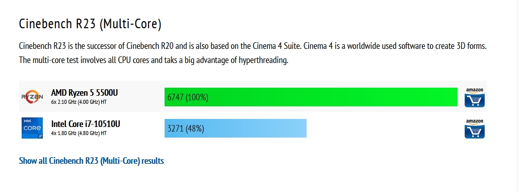

The CPU in that laptop is 4 cores and 8 threads.
You better off with a Ryzen CPU for the same price like a 5500U with 6cores and 12threads.
Has for running multiple VMs I never tried it on a Laptop. In multi thread work loads the Ryzen CPU destroys that Intel CPU by alot.

It does not work that way.
Ideally it should be Ryzen 5 vs Core i5 and Ryzen 7 vs Core i7.
However that is what makes Ryzen mobile CPUS such fantastic value for money the Ryzen 5 mobile cpus can
out perform Core i7 Cpus for much less in multi thread apps . You can see the Ryzen HP laptop is priced less than the HP Intel i7 laptop.
Yet the Ryzen 5 laptop is almost twice has fast at multi thread workloads than the Intel which costs more.
This muti-thread performance and extra cores will make a big difference when you run your VMs has you will have more cores(resources) available for your VMs to run on.
Price wise you cant beat a Ryzen laptop for value.
In-fact its just an embarrassment for Intel that a Ryzen 5 mobile CPU can outperform Intels i7 CPU for less has is evident on amazon.eg
