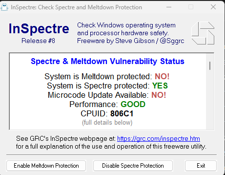

You have to contact your hardware OEM and ask for their Meltdown vulnerability patch file.Hello

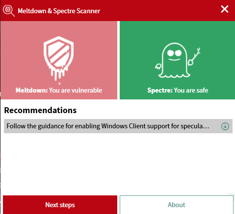

I just checked my PC and discovered that it is not protected against Meltdown vulnerability
Recent PC (2022 august), W11 Pro, Kaspersky Plus.
What can I do ?

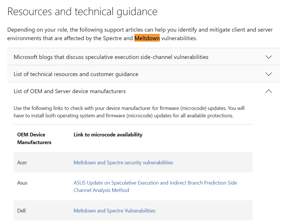

Thanks @OerlinkYou have to contact your hardware OEM and ask for their Meltdown vulnerability patch file.
I would do that before you try any of the fixes provided at numerous online sources.
You should use only an OEM or Microsoft provided solution. Plus, if you do it wrong, it can bork your machine.
KB4073757—Protect Windows devices against silicon-based microarchitectural and speculative execution side-channel vulnerabilities - Microsoft Support
Learn more how to protect your Windows devices against silicon-based microarchitectural and speculative execution side-channel vulnerabilitiessupport.microsoft.com
Look here under

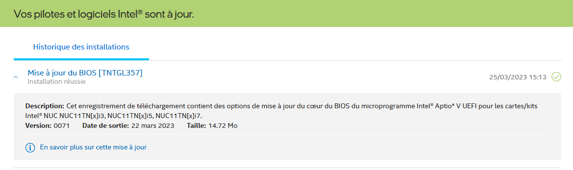

Intel does not provide the fix. The laptop or PC manufacturer provides the fix.Thanks @Oerlink
I have an Intel NUC 11 TNK i5

To put it simply, nothing, since hardware/software devs chose to support only certain devices. I have disabled mitigations for the performance gain, I consider this vulnerability overrated.What can I do ?
reg add "HKLM\System\CurrentControlSet\Control\Session Manager\Memory Management" /v "FeatureSettingsOverride" /t REG_DWORD /d "3" /f
reg add "HKLM\System\CurrentControlSet\Control\Session Manager\Memory Management" /v "FeatureSettingsOverrideMask" /t REG_DWORD /d "3" /f
Performance hits of between 5-30% (depending on workload) were seen in early testing of software fixes, but the effect has been nowhere as severe in practice
Meltdown vulnerability fix is done at bios level and at software level and if one part is missing the test will fail. Search your pc manufacturers website and download the latest bios version and install it ( bios software don't get auto updated, you will have to install it manually). This will fix your system.Hello
