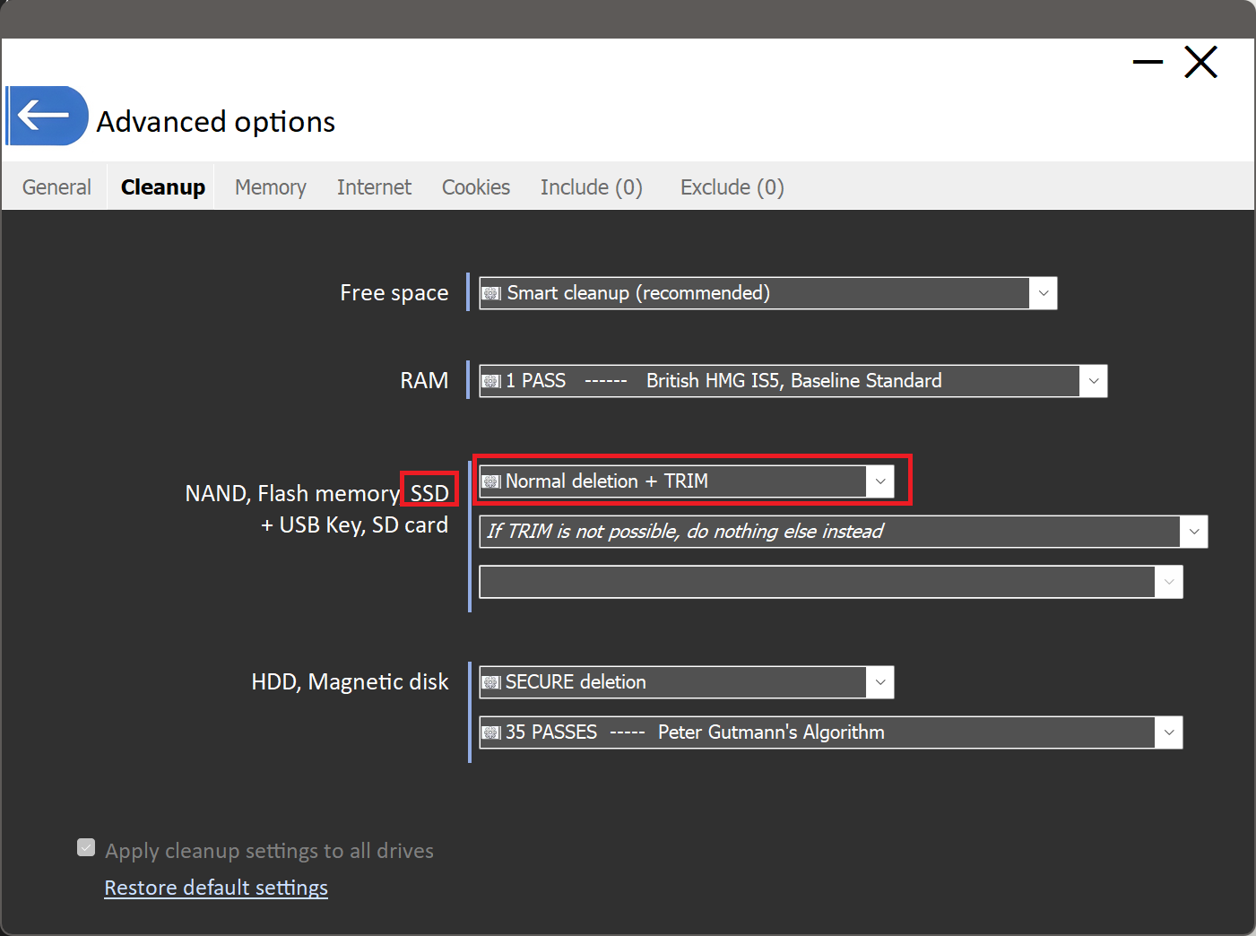

PrivaZer is a popular junk file cleaner that includes additional privacy measures, such as secure deletion of files and securely wiping free space on drives. PrivaZer is my junk file cleaner of choice.
However, if you’re running an SSD, there are a couple of PrivaZer settings you should be aware of.
PrivaZer can be useful, but the SSD-specific concern is real.
Why SSDs are different
Traditional “secure overwrite” methods were designed for HDDs. On SSDs, wear-leveling and over-provisioning mean:
  • You cannot reliably guarantee that a specific physical cell was overwritten.
  • Repeated wiping can create unnecessary write wear.
  • Free-space wiping is generally less meaningful on SSDs than on HDDs.
Because of that, using aggressive wipe settings on an SSD is usually not recommended unless the vendor documents a safe SSD-aware method.
What to be careful with in PrivaZer
If the drive is an SSD, the settings that usually deserve caution are:
  • Secure deletion by repeated overwriting
  • Wiping free space
  • Any option that performs large amounts of unnecessary write activity
In general, TRIM plus normal deletion behavior is the more appropriate approach for SSDs, rather than repeated overwrite passes.
Practical guidance
A safer approach on SSDs is:
  • Use PrivaZer mainly for ordinary cleanup if you trust the program and need its features
  • Avoid repeated secure overwrite passes on SSD-stored data
  • Avoid routine free-space wiping on SSDs
  • Make sure TRIM is enabled in Windows
  • For full-drive sanitization, use the SSD manufacturer’s official utility or a documented secure erase/sanitize procedure
Important limitation
I cannot verify every current PrivaZer option or how its latest version handles SSD-specific operations without checking the official documentation for that exact release. So I would treat third-party advice cautiously and compare it against the PrivaZer manual and SSD vendor guidance.
Bottom line
The main point is correct: SSDs should not be treated like HDDs for secure deletion. Cleanup is fine, but repeated overwrite-style wiping and free-space wiping are generally the settings to avoid on SSDs.
The Correct Way To Use PrivaZer On SSDs

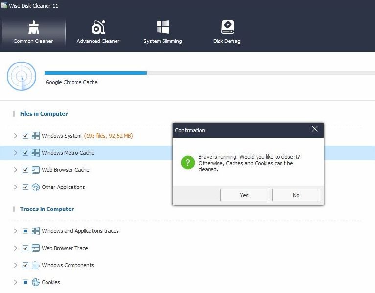

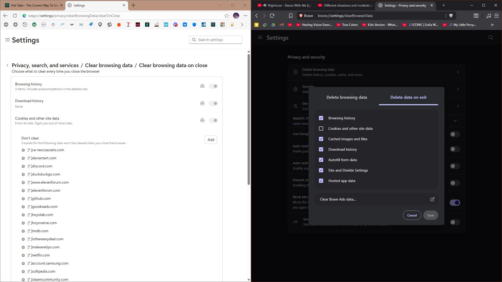

I imagine this is the case for all Chromium? Any one check?
Aged cleaners are used to this, Wise asks to close browsers like Edge or Brave.
even then results are mixed, history/data survives.
I triple clean Edge's cache, except cookies.
1. Clear browsing data on close
2. Wise Disk Cleaner
3. Manual Cleanup

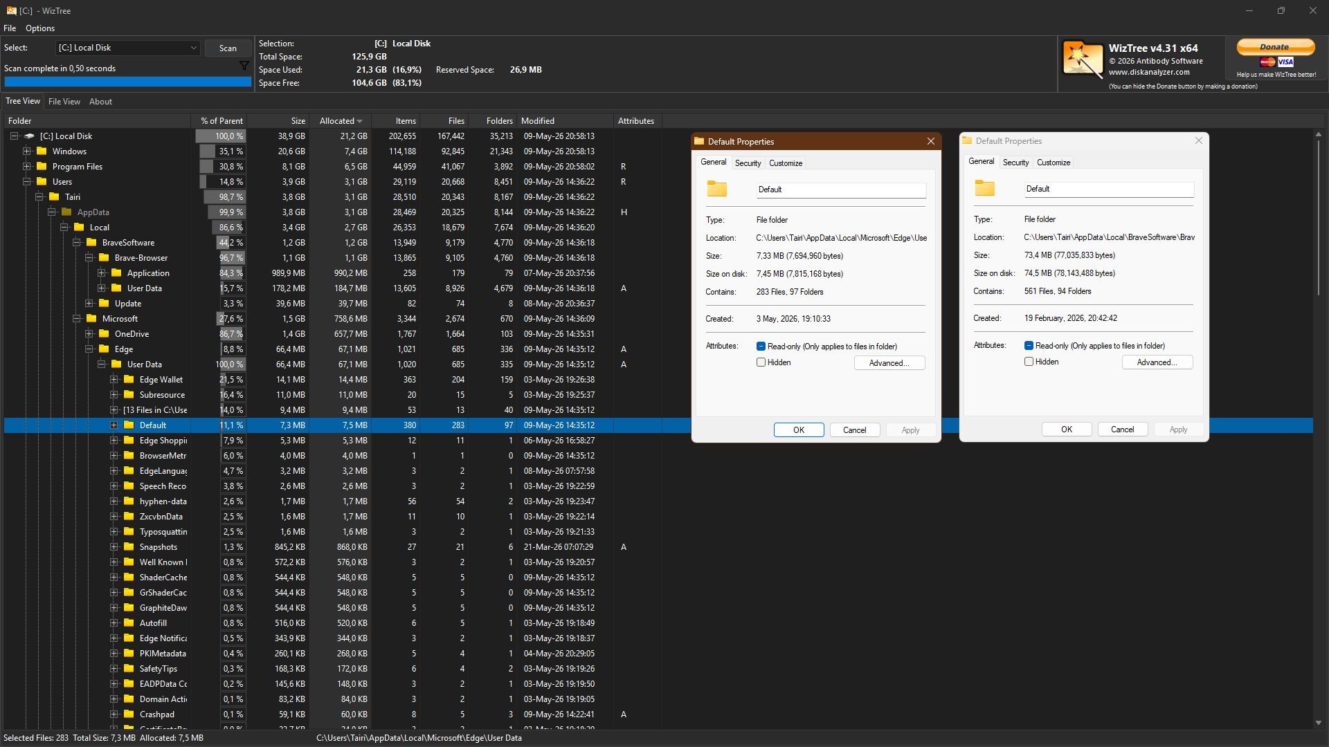

Sadly 11 hates RAMdisk, moving caches and symlinks no longer work correctly, so I was forced to abandoned that approach. ☹️

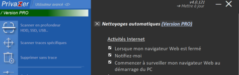

The biggest problem with all cleaners is that they can no longer clean Edge unless you kill Edge and all it's processes even then results are mixed, history/data survives.
Does Microsoft Edge keep running in the background when you close it? If so, you can turn it off from the settings so that it closes completely when you close it.
In my case, all Chromium browsers close completely when I close them, and I wonder why they close in the system tray for some users, which has never happened to me. Perhaps it has to do with extensions or settings.

Hello,
PrivaZer is completely safe and "okay" to use on an SSD because it changes how it operates depending on your drive type.
Here is exactly why it won’t ruin your SSD:
PrivaZer doesn't treat an SSD like a mechanical hard drive. It detects your hardware and adjusts its behavior.
The moment PrivaZer starts scanning, its algorithm identifies whether your drive is an HDD or an SSD.
If PrivaZer detects an SSD, it uses TRIM by default as you can see here :
This tells your SSD controller exactly which blocks are no longer needed, allowing the drive to wipe them naturally through its own background garbage collection.
That's why PrivaZer is both secure and highly optimized for SSD health.​
