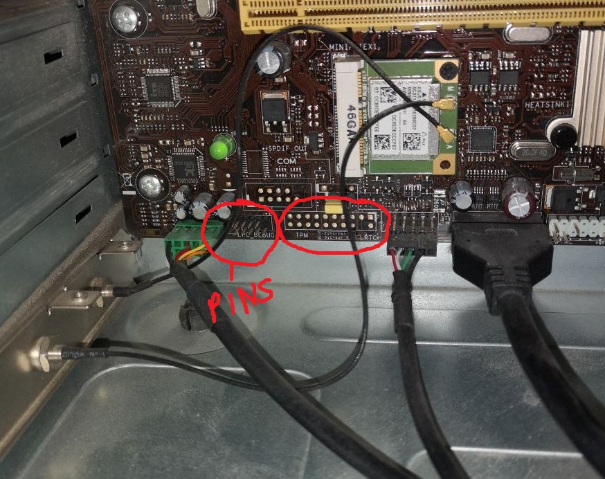

It is the same component I have been looking at. UEFI has not option to check if TPM is enabled, all I know that my AMD Asus PC has a slot for TPM but it has not those pins sticking out as in the picture below. Are they needed? if so what's name and where to get them in order to install the TPM component as I have seen on some pictures and videos on the net. I am sorry guys but if anyone can direct me with this, thanks!

It is the same component I have been looking at. UEFI has not option to check if TPM is enabled, all I know that my AMD Asus PC has a slot for TPM but it has not those pins sticking out as in the picture below. Are they needed? if so what's name and where to get them in order to install the TPM component as I have seen on some pictures and videos on the net. I am sorry guys but if anyone can direct me with this, thanks!View attachment 259491
See post 5
Is the UEFI setting set to 'advanced mode'? Otherwise, you wouldn't see the item that sets the TPM. There should have been a place to switch between simple mode and advanced mode at the bottom.
