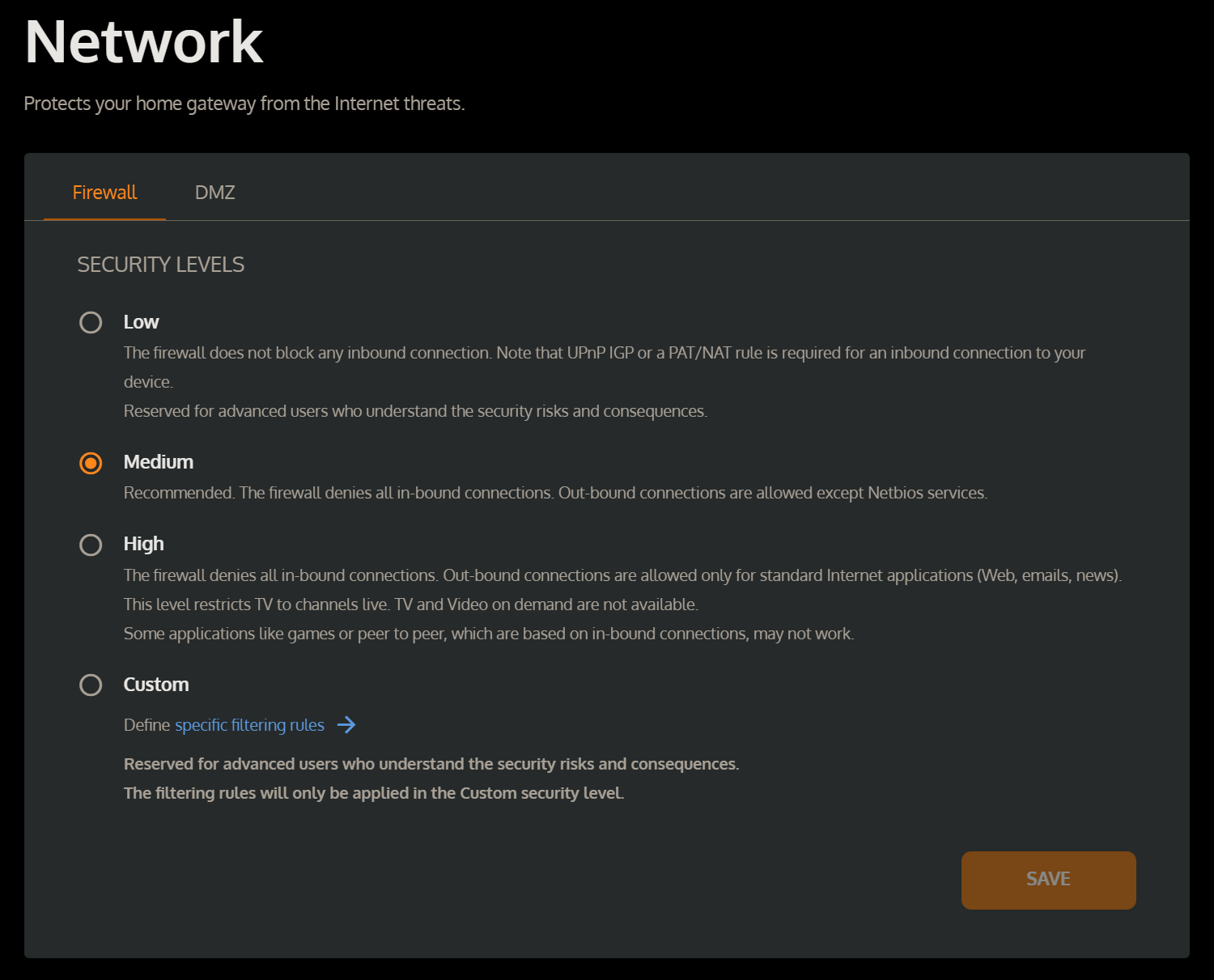

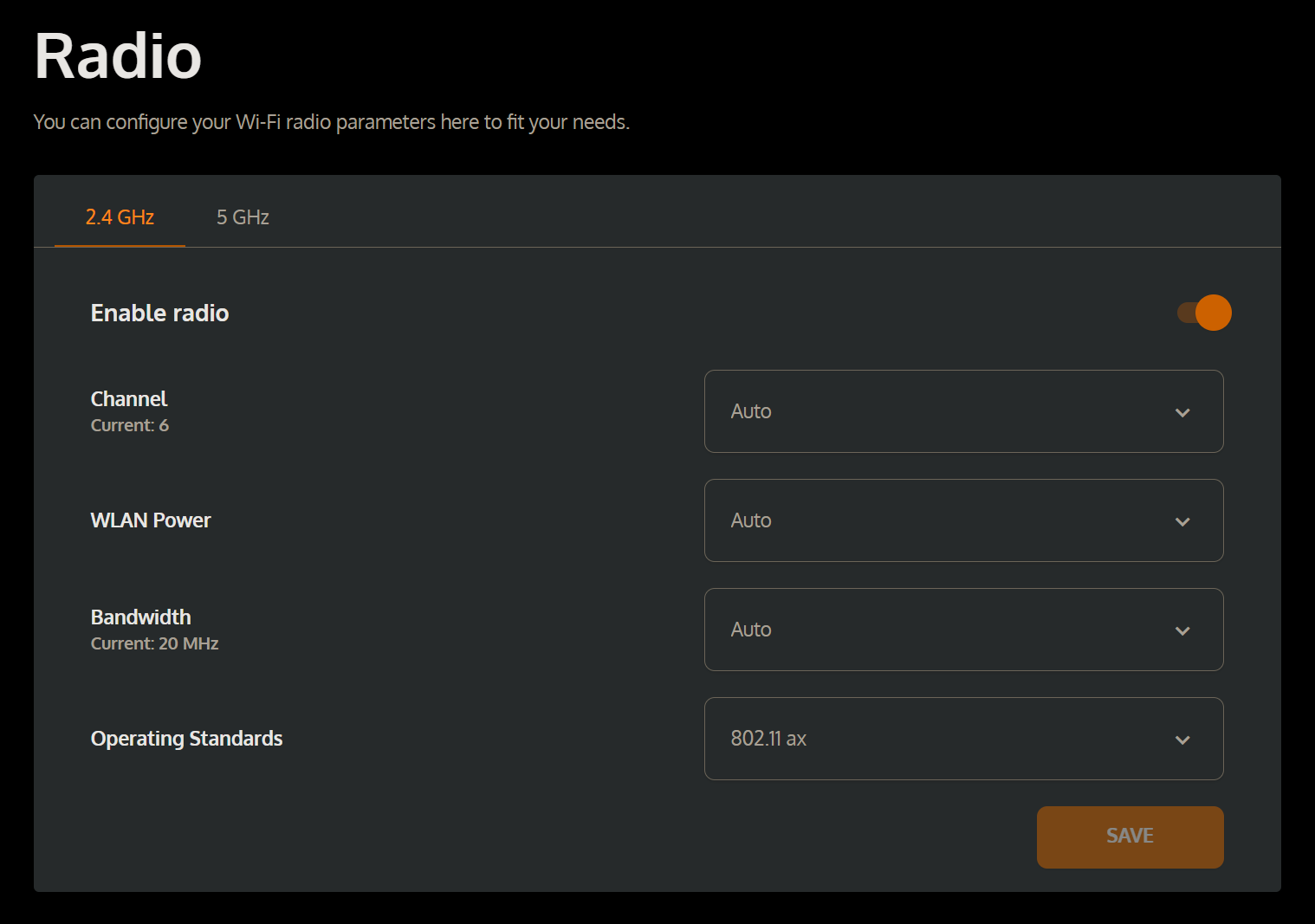

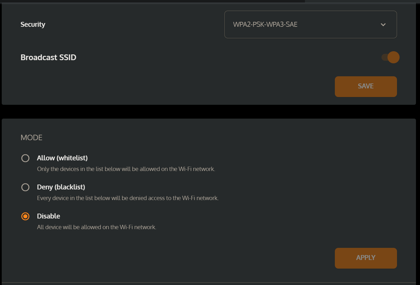

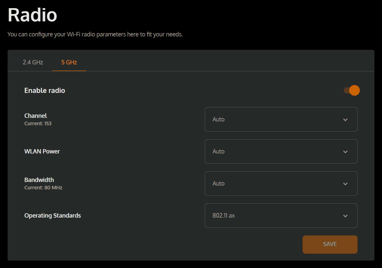

To ensure nothing is missed, here are the available settings on my ISP router. Are they configured correctly, or do you recommend any modifications?
View attachment 299115View attachment 299116View attachment 299117View attachment 299118View attachment 299119
Well, there's not much you can change and most of these don't have any effect on security anyway. I'd change default DNS servers though.

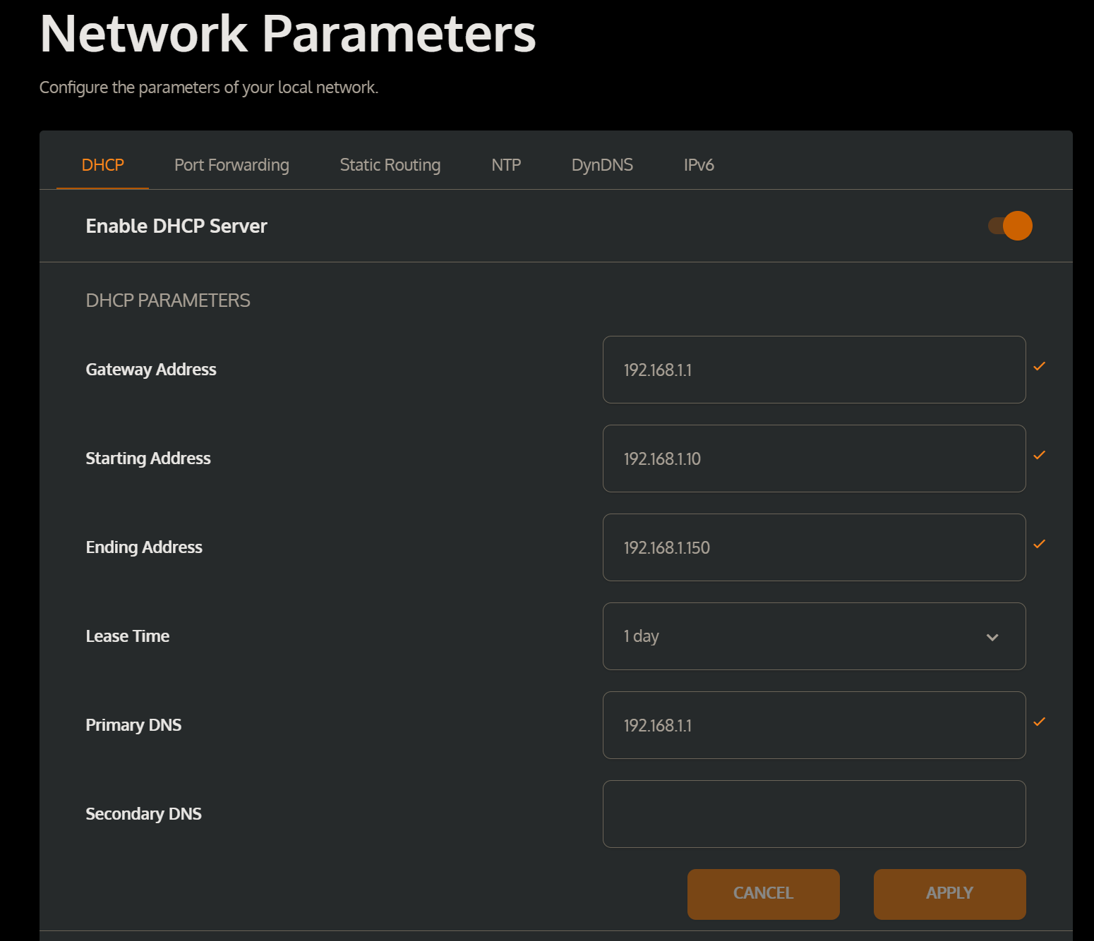

I tried changing the "Primary DNS" to 1.1.1.1, but when I tested, it still indicated that I was using an ISP DNS. Should I change the "Gateway Address" instead?
No. Gateway address is the IP address of the router itself.
Change it again, put 1.1.1.1 as a primary DNS and 1.0.0.1 as a secondary DNS. Save settings and restart the router. Then, clear the DNS cache on your device and
go to dnscheck.tools to see if Cloudflare appears as your DNS. If it's still showing your ISP DNS, we'll go further steps.
Your browser could be bypassing the router DNS. Turn OFF SECURE DNS in your browsers. Then if your router has the capability to force all clients to use the router DNS no matter what config is in the browser,then there should be no bypass. Asus have this option.
I didn't try restarting the router after changing the DNS, so perhaps that was the problem. I'll try again tonight.
You didn't say, but I'll mention here just to make sure. Once you change the DNS on the server, you may need to disconnect and reconnect the testing device to grab the new configuration.
That is usually the address of your router.

I tried, but it still displays my ISP DNS. Is there anything else I can do? Also, I saw an entry at the bottom of the screenshot that I didn't add, so I'm not sure if that's by default or something.
Cloudflare DNS is quite popular and often blocked in authoritarian regimes. Let's try with less popular DNS servers (we obviously don't want to use them, just test if it works). Use DNSGuard, dnsforge.de or Hagezi DNS.
Make sure that your network adapter is set to get IP addresses automatically through DHCP and that you also clean the DNS cache using ipconfig /flushdns in CMD.
Now... if you don't see your ISP DNS servers on browserleaks.com/dns or ipleak.net anymore, that means your ISP is censoring Cloudflare DNS and forwarding all queries coming to 1.1.1.1 to their own DNS servers. You can't use popular DNS services this way, but you can less popular ones.
If you still see your ISP DNS servers, that means the setting in router was made like this on purpose and it doesn't have any effect no matter which DNS you choose. The only way is to use your own router or the simplest solution, set DNS manually on all of the devices connected to the network.

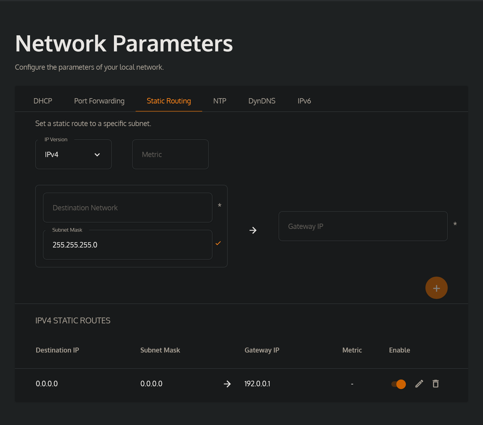

The screenshot of the settings you took, doesn't show anything suspicious that might cause an issue with DNS.
I've had ISP routers in the past that are hard wired with often fixed settings potentially to cut down on support when things go wrong, on of the reasons I use my own plus there are other benefits with a guest SSID & IOT SSID, & the ASUS I have seems quite intelligent as to connections, but not everyone can use their own & I fully appreciate that, if you can use your own router there are distinct advantages, but often your ISP wont help you if its not there router, ISP own routers are usually made to the lowest cost they can get so?
In my country, ISP routers generally don't allow you to set your own DNS servers; the setting is locked behind admin account. However, under EU law, they are required to either give you bridge mode or completely remove their equipment so you can connect yours. You can use any DNS service you want because the web isn't censored at all. Only illegal casinos and betting sites are blocked on ISP DNS servers, that's all.

It doesn't work either; it appears to be blocked by the ISP.
We have a TP-Link Archer C6 router that was connected to the previous ISP router and allowed me to override its settings. However, the new router has an extender/repeater, and since this is my first time using it, I'm not sure if I can connect the two and if the repeater will function properly. I connected the repeater yesterday using the quick setup guide, and it is functioning, but I am unable to access its control panel to check its settings. All I get on the ISP router dashboard is that the repeater is connected and synchronizing the router Wi-Fi settings, so I'm not sure if I need to do anything or not.
Unfortunately, that means the setting is there purely as a decoration. They probably couldn't hide it, just lock it behind the admin account.
