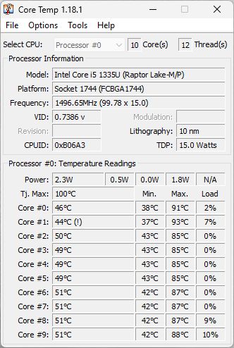

So, the results are in. After 45 minutes, all tests conducted were passed and the temp ranges between 44° and 82°. So from my understanding, everything seems okay.

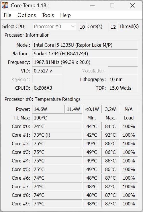

Update: I bought a new fan as the old one was noisy. After fitting I repeated the same test with Prime95. After 21 minutes (half the original time) I stopped the test. The temp results are below.
The highest temp is 11°C higher than with the old fan . This fan cost me 30 British pounds, so I thought it would be decent. There's an exclamation mark next to the Core #1 so I'm guessing this is too high. Is there a better place to source a fan for a Dell Latitude 3440 laptop?
Thanks for your help.

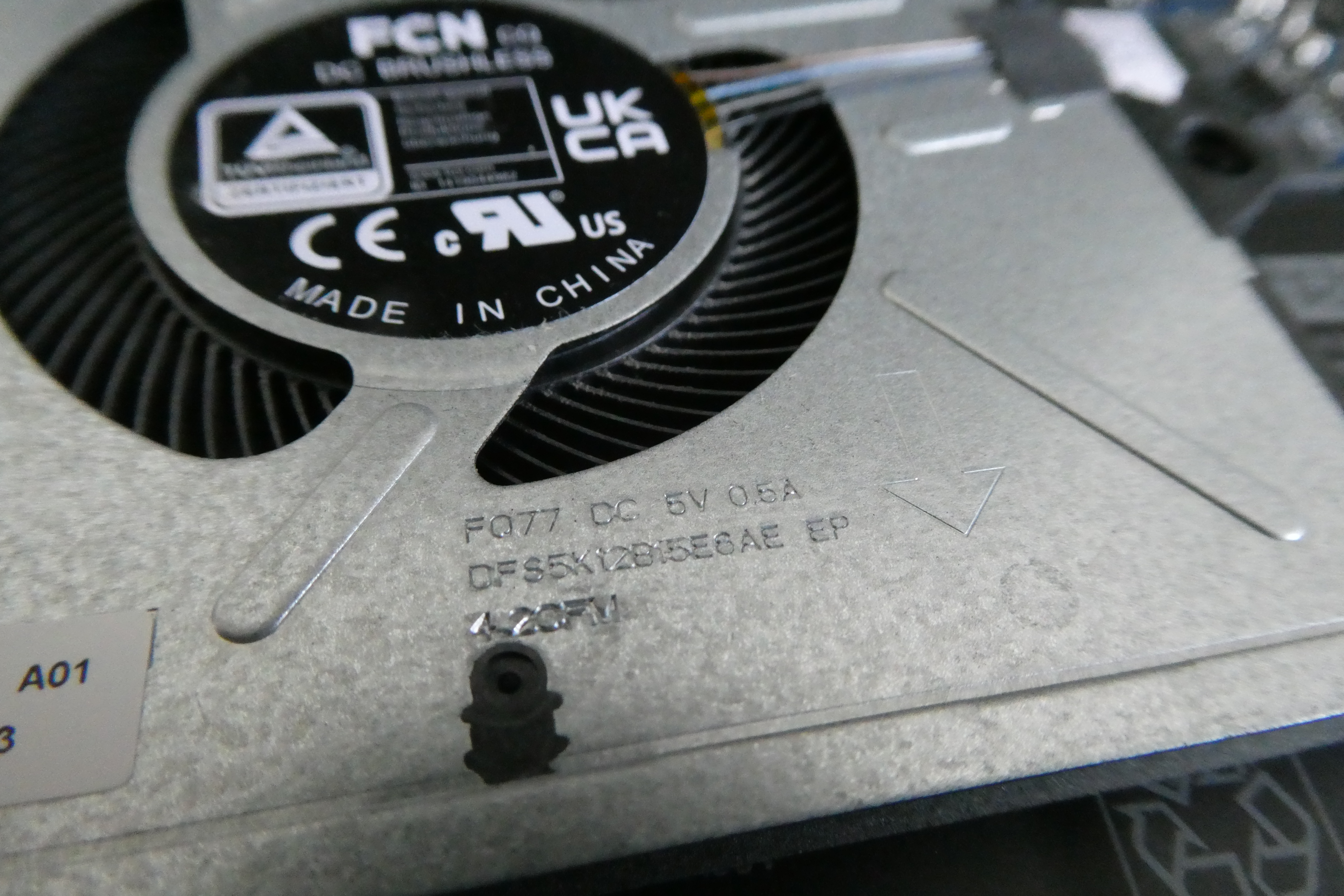

Did you replaced it with the same Fan with the same RPM or totally different? Also ensure you are testing using power plug instead of battery to ensure no power saving is happening and limiting the fan speed( check power settings )
Oh, I didn't plug in the charger this time... Would those results be acceptable on battery power or would the temp still be too high?

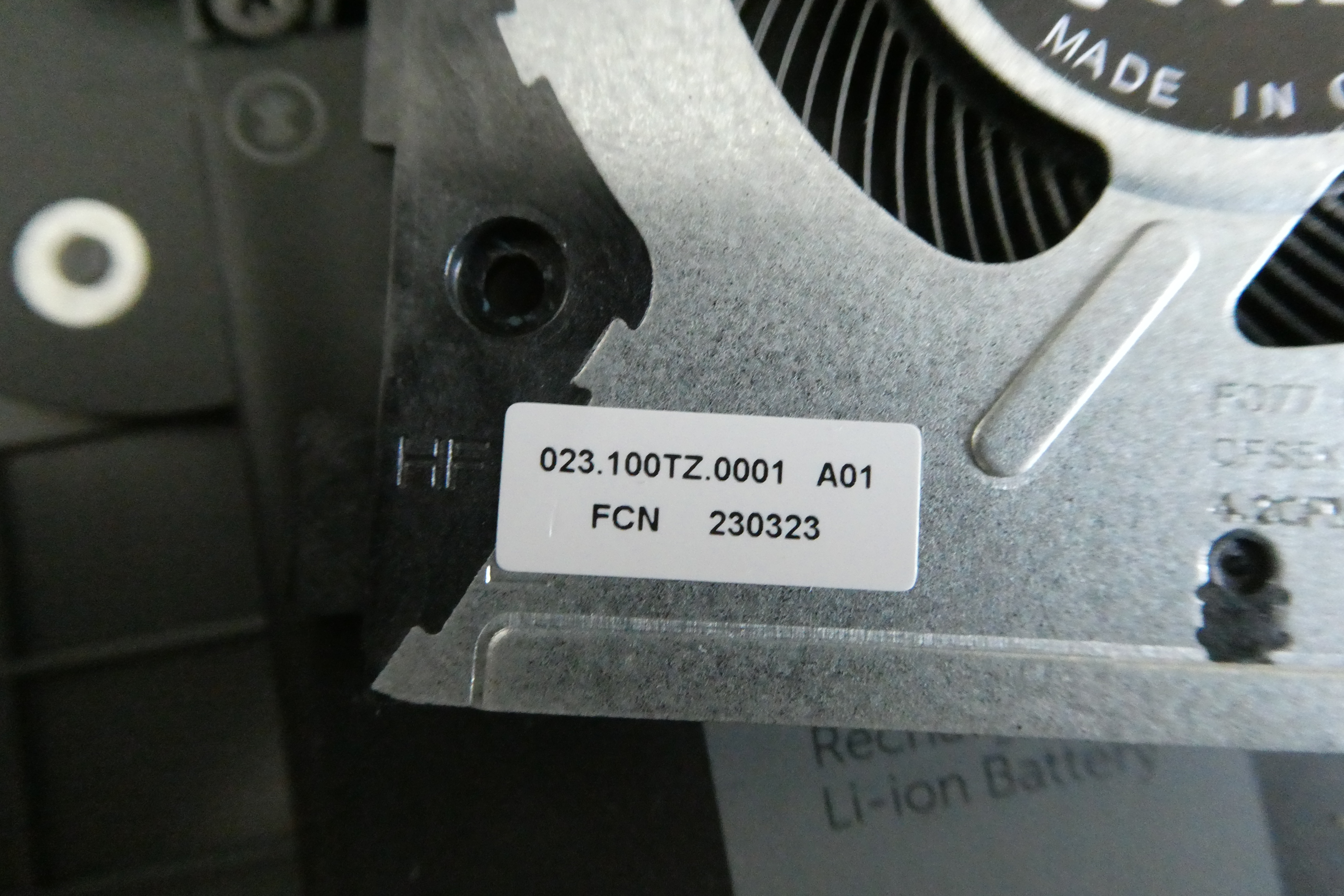

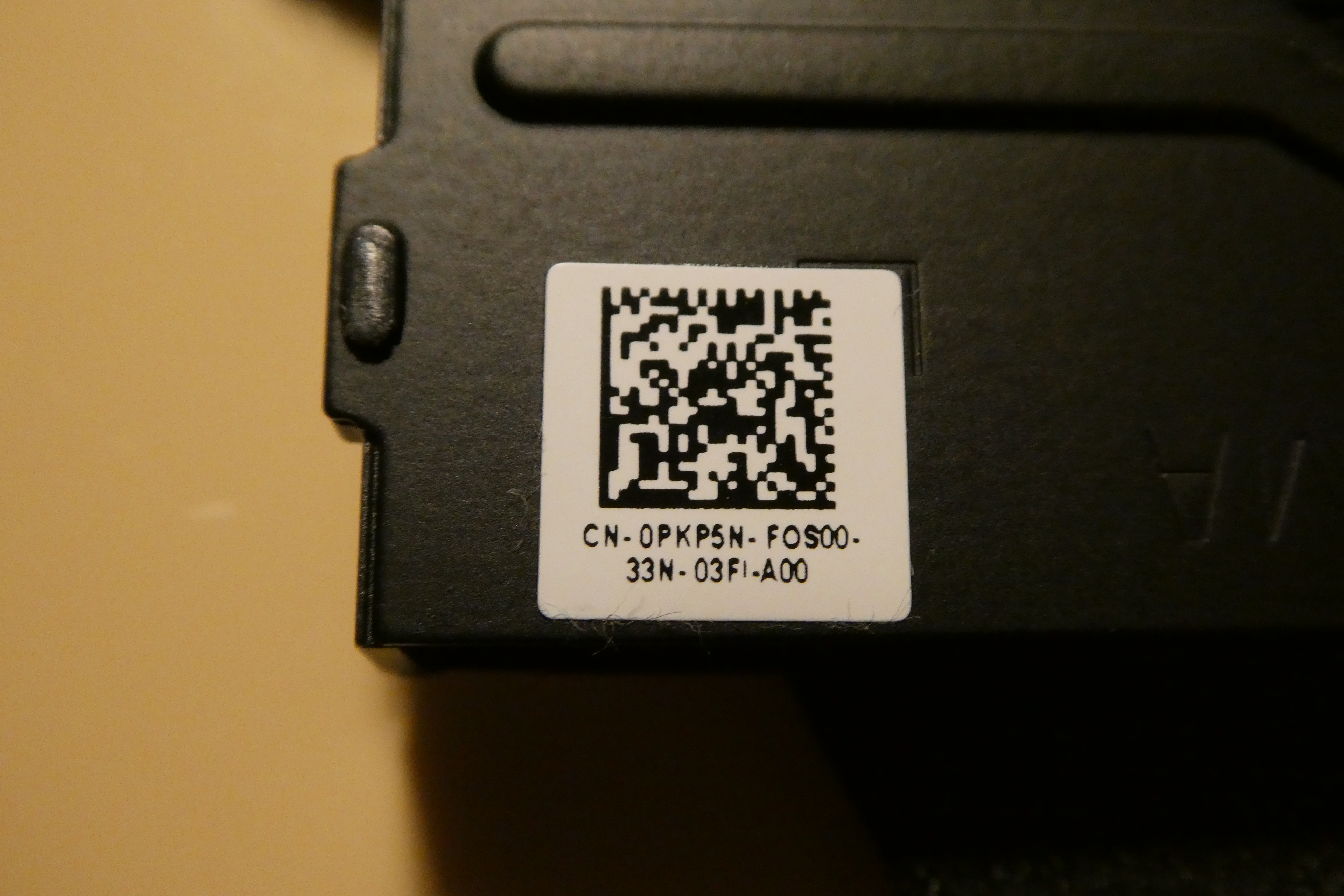

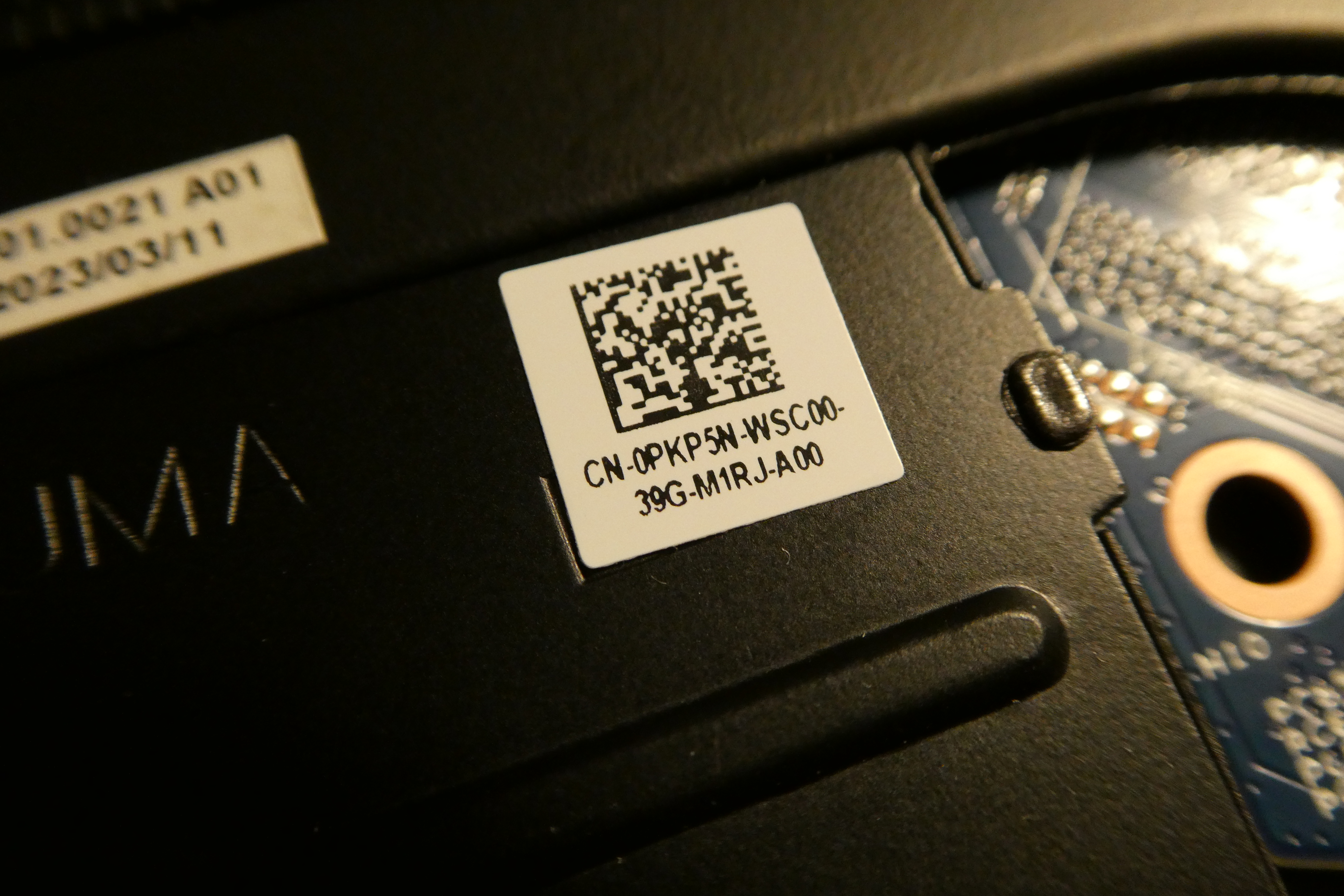

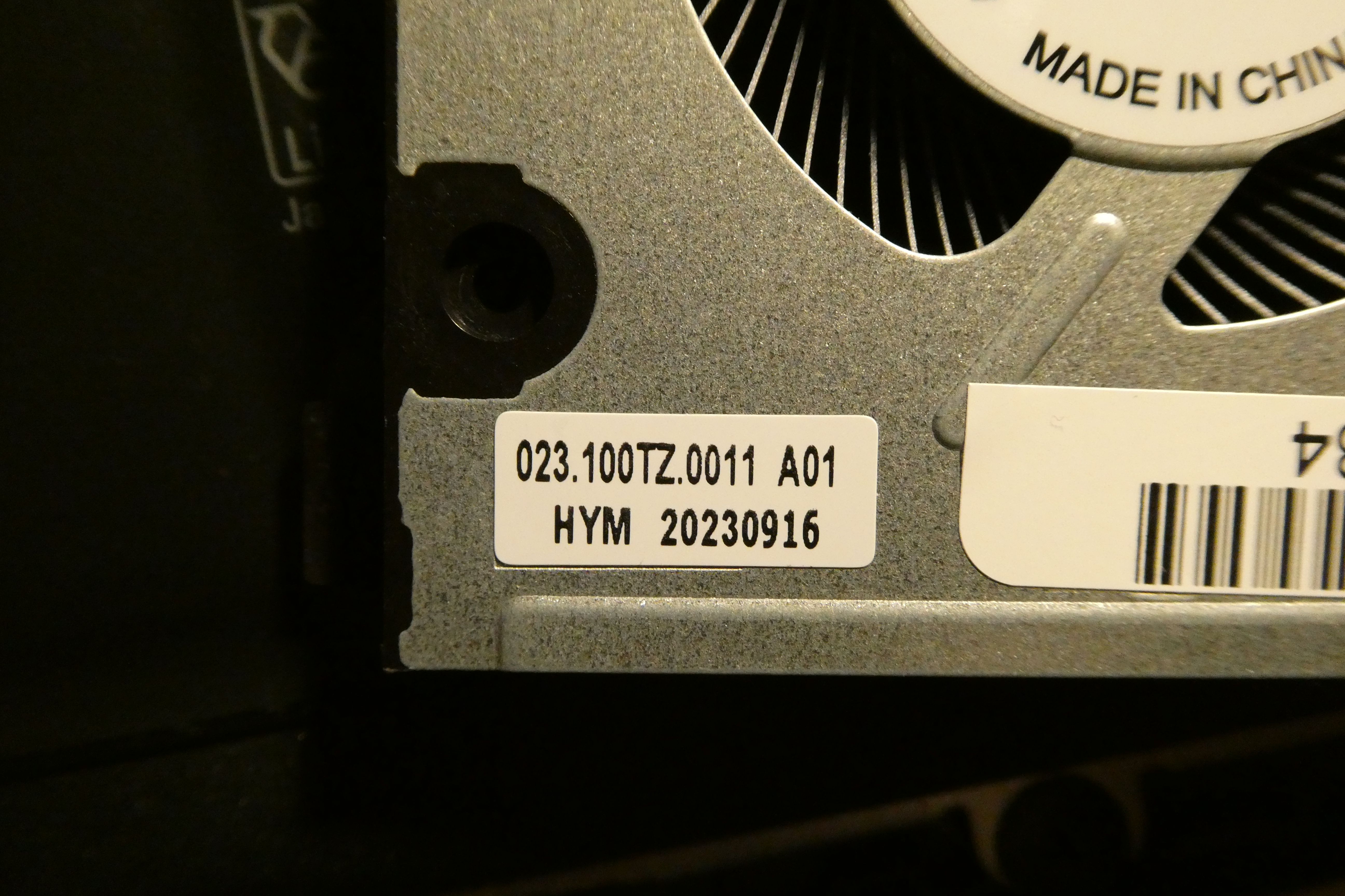

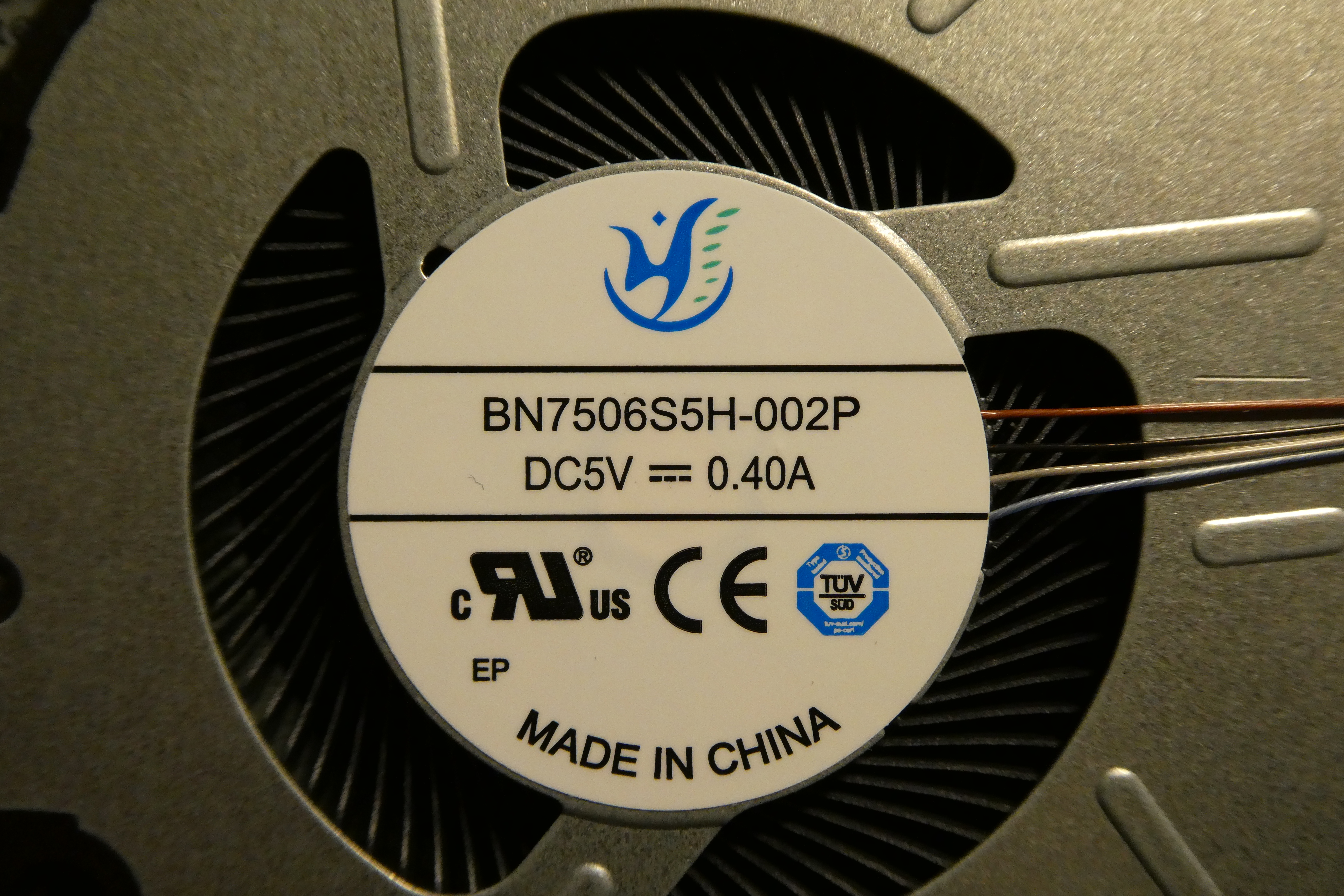

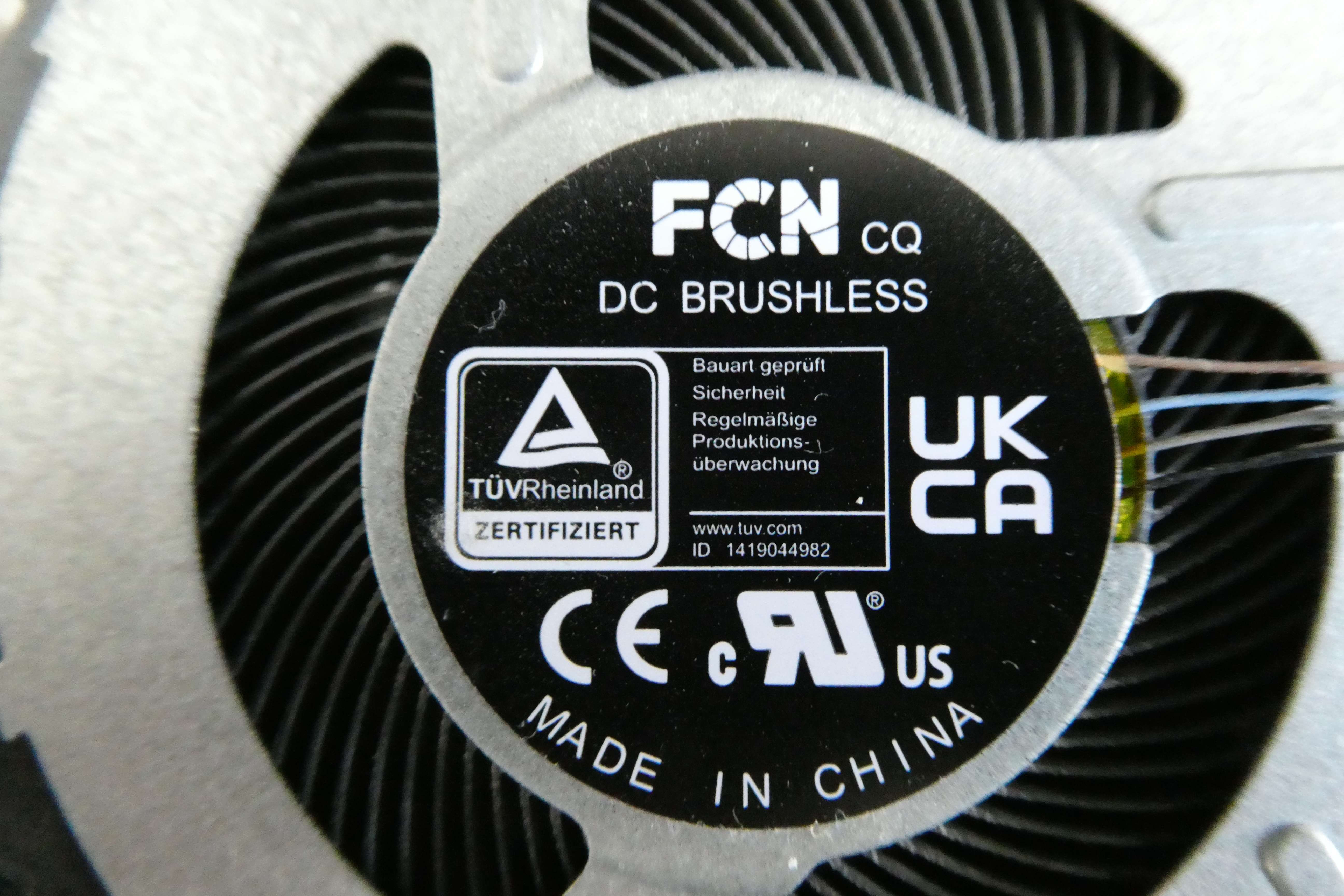

I can't see any mention of RPM speed on either fan. I did notice that the old fan is 0.5A and the new fan is 0.4A.
Here is the old fan,
Here is the new fan,
Reactions: Sorrento
Likely different RPM as the Ampere is lower.

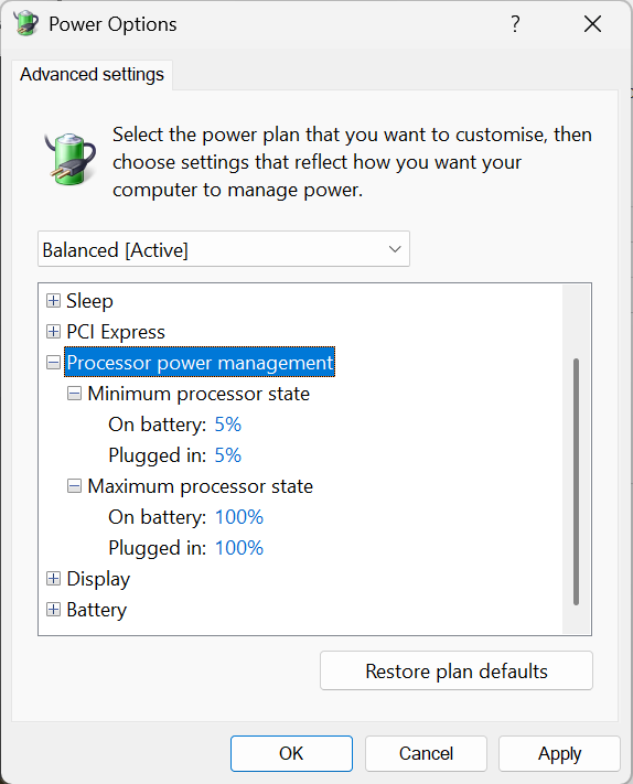

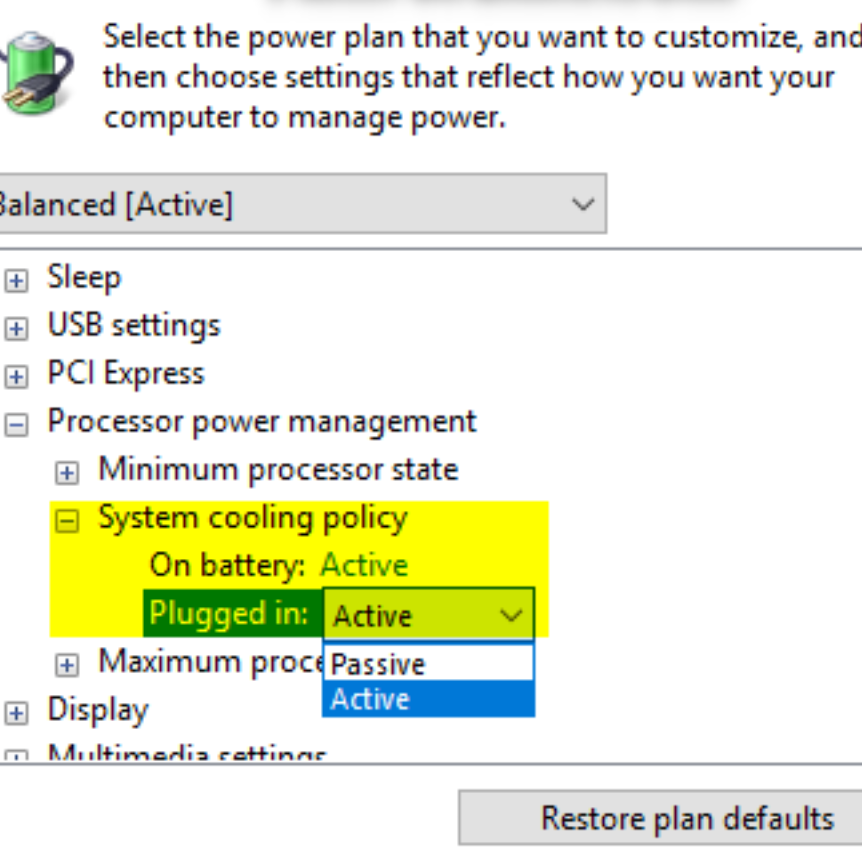

This is the setting that can affect the Fan if on battery/plug and if it's Active (more usage of fan) or Passive (Natural Heat Dissipation)

I just put the old fan back in as I was seeing high temps during general use. I decided to do another test, with the charger plugged in as before. I stopped it after 12 minutes. The results are now similar to the new fan. :confused:
I can't find that setting
It's still well below the TJMAX (safe operating temp)of 100c. Either repaste or leave it as it is.
