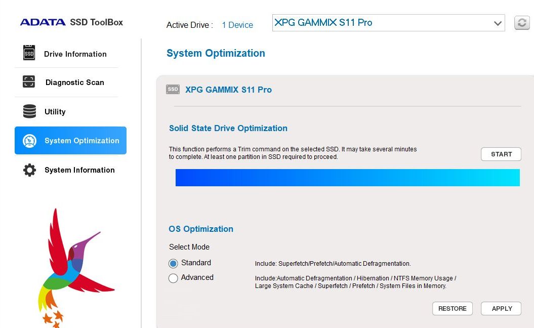

I know part of this was discussed in earlier thread but came across another program that says it does these windows settings to help with SSD life and wanted to know if it's true and just easy to configure manually?
Timestamp deactivation
• Windows stores the access time for each file access. This produces unnecessary write hits and thus will reduce the lifetime of your SSD. Disabling of this feature is highly recommended.
Prefetch off
• Prefetch supports preloading of frequently used applications into RAM. Because of the fast access times off SSDs, this function is useless and can be disabled.
Disabling the defragmentation of boot files
• Because of the way that files are stored in SSDs, a defragmentation of boot files makes no sense and should be disabled as it reduces the lifetime of your SSD. (This is already a no brainer!)
Deactivation of the Windows event logging
• Windows permanently records system configuration changes, as well as crashes and other events from various services and programs. This creates unnecessary write accesses and reduces the lifetime of your SSD.
Storing short name off
• For compatibility with old 16-bit DOS applications, Windows creates short names for folders and files, which results in additional write accesses to your SSD. Current applications do not need those names, which is why they can be disabled.
Usually SSD manufacturer's take care of that, if you use it's tool to maintain SSD. When I want to trim, it applies optimizations automatically.
