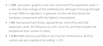

If you can rule out other Windows factors, you might have to consider a hardware issue/s. There's a Lenovo diagnostic tool but I'm not sure if it'll run on your machine. Worth a try, maybe. Otherwise, you can look if Fast Startup is disabled. Control Panel / Power Options /Choose what the power buttons do /Change settings that are currently unavailable.
If the machine has USB ports the newer variety of external CD players may be backwards-compatible--provided the power supply is delivering adequate power via the 5th voltage rail. This assumes you have a 64 bit machine.
Source
Upvote 0
